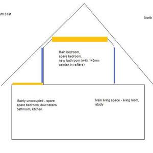

    Insulating eaves rooms
    This is a drawing of what I'm working with.... I'm hoping this might prompt some responses! :D As I mentioned, the loft has been fully insulated, with the 100-200mm that was there originally, and 200mm space blanket on top laid at right angles. There is apparently sufficient ventilation in...
    My god, I cannot believe the price of Celotex or even just polystyrene compared to rockwool / space blanket! :shock: I accept that roll insulation is being subsidised at the moment, but why not other types of insulation? Any cheaper options?? Should I rule space blanket / rockwool out??
    We live in a chalet style dormer house, and therefore the first floor rooms are cut into the eaves. We also have a loft, which I've fully insulated. The first floor rooms are rather cold though in this freezing weather, and the heating (in the dormer window) in the main bedroom isn't...
