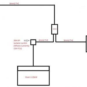

    Confused about Bosch oven instructions
    Thats fine, don't mind it being a useless switch under the worktop, as that's what I have now. And sorry I missed everyone saying it was fine before I updated this thread so sorry if i sounded like i was repeating myself. Thanks to all. I will fit a 20A DP Switch like this...
  10. M
    Cant get a picture but the diagram is accurate, not sure how a picture would make it clearer. I just want to know if, according to the picture, I can replace the 13A FCU with a 20A DP switch as mentioned above
  11. M
    Can anyone confirm my diagram as I need to get the bits tonight for fitting. Thanks
  12. M
    Here's a quick and crude drawing of my plans based on what i thin kis now fine to do. Does it look ok? Is any of this notifiable work?

  15. M
    Yes that is exactly the thing I was looking to do. I didnt know what the correct rating needed to be for the switch or flex outlet plate. So 20A is fine and not too high?
  16. M
    Sorry I think there was a bit of confusion in my last message. I am aware of the difference but I wasn't clear. So I have the cooker connection unit on the wall, from here there is a cable to a 13A FCU, and a cable direct to the Hob. Im not doing anything with the CCU, what I wanted to know...
  17. M
    Ok the cable going from the cooker point to both the hob and the FCU appear to be at least 4mm2 and judging by the measurements here: http://www.diynot.com/wiki/electrics:cable_types:flatpvccables They actually appear to be probably 6mm2 cables. With regards to the exisiting FCU, it is some...
  18. M
    I've just looked at the old hob actually and that is rated at 7kW on the device itself, so more than the new one, so I think we are safe on that front. In terms of the new oven, the model is HBN331E2B. Putting that into the Bosch manual site, it gives loads of results...
  19. M
    And just to add, the hob is 6.2kW. With the oven that is a total of 8550W, so around 35-36A, but am I right to assume that will be ok when taking diversity into account?
  20. M
    I am having a new Bosch single oven delivered tomorrow. Currently, I have a 32A MCB feeding a cooker isolation point. From there, there is a direct wire to the electric hob and another wire to a 13A FCU which the old oven was connected to. I purchased a new hob and oven with the intention of...
