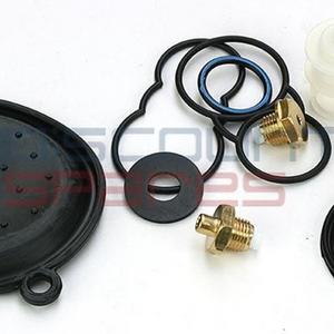

    I'm just doing the DHW Valve for now. Some parts in kit are for Flow Valve & Diverter Valve I believe, I'll do those another time. Just want to know how many parts are for DHW Valve ??

    I'm looking to now change the DHW Diaphragm. There is also a small weep around the pin which pushes the microswitch. Reading other threads, I think I will have to change the seal around the pin which comes in the Vokera Excell T0019 Service Kit, which I think is one of the brass sealing...
