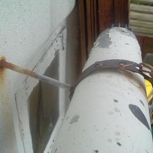

    The plumber put a new clip around the flue & removed the remnant of the old clip & pin. I now realise the flue by itself is solid as a rock & can support itself without any clip, no movement whatsoever.

    Only in last couple of years the flue has been put down to Not to Current Standards, it's been like that since 1995. The boiler is in the outbuilding to left of flue. In 1st picture the flue continues to left for about a foot before turning into this outbuilding. My backdoor is a foot...

    Any ideas how much it will cost to replace roughly ?? Here are some pictures: Ps: I like this new upload image facility on diynot now,very handy.

    The flue is fixed to wall by a circular clip with 6"+ rod/pin going into wall. This clip has rusted & broken on side away from rod/pin. How much roughly would it cost to replace ??

    Just had a Gas Safety Inspection on boiler on last day of current Gas Safety Certificate. Plumber didn't issue new gas safety certificate, is going to give Warning that flue fixing needs to be replaced, it's rusted & breaking up, but still solid with no movement, so I assume I don't have...
