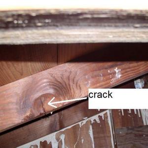

    metal rafters
    I have four sagging rafters in garage in my 1952 home. They are 2x6 and all side by side. All four have knots in about the same location, resulting in sagging. I got 4 2x6s to sister these, but that's a lot of weight to add side by side. So, Im thinking of using angle iron, as least for two...

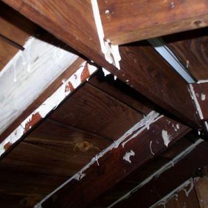

    looking for rafter straps
    I need to secure these rafters to the cinderblock top plate. They are just toe nailed in now. I want something stronger that i can screw in w/o removing the planking. Any ideas? I might install rafter ties, but Im looking for alternatives. pics...

    How to install rafter sister?
    three rafters where the roof sags have a measurable curve to them. 3rd one is totally destroyed by termites. Every place that I touch it, it crumbles.

    house built 1952. A few rafters cracked and one is split. Im considering adding supports. Advice? tks, pa
