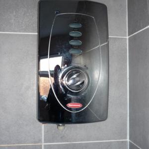

    Redring electric shower stopped operating
    I have a redring electric shower, model no. 53-558202, which has suddenly stopped operating, approx. 5 years old There are 4 red indicator lights and buttons on the front panel, 3 for different heat settings and the fourth for turning off. The low heat indicator light works, as does the off...

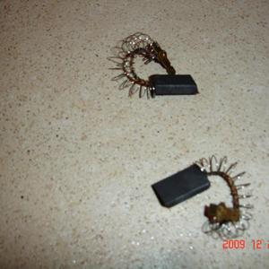

    Hi It's a bosch 1400 s express, bought in July 2004. I've removed the brushes which can be seen on the attached photo, not sure if these would be considered worn? Basically, every wash setting starts with a fill through the drawer. The water reaches a certain level in the drum then it...
  8. brushes
    brushes
    motor brushes bosch 1400 s express washing machine
