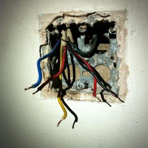

    I've got 46 volts between black wire and earth
    I'd rather have some help thanks
  8. coolhands
    with switch connected and light on I get: between yellow / ground 33v between reds / ground 33v between blue&black / ground 33v with light off I get between yellow / ground 89v between red / ground 89v between blue&black / ground 65v perhaps there is no problem but can someone tell...

    yes I definitely had it on 500v ac.

    here. Yes I first noticed the neon light up which is why I started checking with a voltmeter. I got the stated voltages when I checked between black and earth and red and earth on the incoming cable. sorry hard to get pic on iphone there are some shadows in above pic

    there are 2 cables. One has red, black and earth. The other has red, blue, yellow and earth and links to the 2nd switch. Yes the earths at both switches are attached to metal back box. I will post pic shortly its difficult as I am on a tablet not proper computer.

    ok I just tried the switch - the small box with the old fuse does indeed isolate the circuit :? Lesson learned. I will now leave alone - but I am basically needing an electrician to sort out the earth is that right? Is it worth me checking the earth wire in ceiling rose?

    I did not isolate it since I couldn't - I was just careful ;) I will switch that switch off tomorrow and see what does.

    has white spots says 5amp. Old fashioned style fuse.

    I'm not sure what the single metal box does that says 'on' to the right does. (there are 3 flats '0' is the basement flat)
