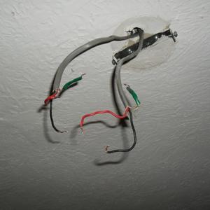

    Help with new kitchen light.Will not switch off and trips
    Ok thanks. Sorry to have been a dipstick! ;)
  2. H
    just making sure here:,but the switch has been wired as such: BLACK L1 RED COM BLACK L1 RED COM Is this wired ok? seeing as though the reds are taped the other end? lee
  3. H
    yep,sorry chap. Switch it is then :(
  4. H
    Andy, ive just taken the switch off and the lights are not going on, so im assuming its not the switch buddy.
  5. H
    Also, the switch doesn't turn the light off at all, which is a good thing as it was tripping before Andy helped me :)
  6. H
    Ok guys, Ive just done that. The two black wires are now in the terminal. However, the bloody switch still will not turn the light off.
  7. H
    Thanks buddy. So im just going to use the blacks and that's it? There are only two terminals on the block on the light itself, and im assuming you are saying just put one black in each terminal
  8. H
    Hi guys, I have two tri spotlights in my kitchen and one lamp went haywire this week and started to play up. I decided to change it. However, when I started to change it today I realised I had a problem. Basically its an oldish house with the old style wires. 2 red, 2 black and two bare with...

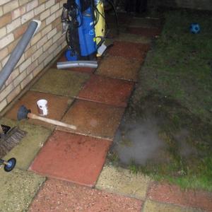

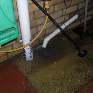

    Urgent help with Sink/Washing machine waste drainage.
    Thanks chaps. We had the water board out a while back and the manhole cover in the middle of the road wasnt blocked.He flushed it quickly,and it unblocked therefore leaving tge water flowing to the drain in the road.It lasted 3 months then blocked uo again. The pipe in the photo is a rain...
  15. H
    Hi guys, New member here.Please look at the two pictures i have provided of the blocked drain which has been caused by the sink and washing machine waste.Am i right in saying i can change this plumbing to allow both wastes to empty into the main sewer which is just out of the picture on the...
