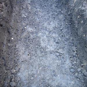

  10. Shinogi
    Wall Foundation near drain cover
    I've started digging down to where I'm going to lay the foundation. I've hit clay at around 250mm. Am I right in thinking I should dig down to 300-350mm and follow the advice given above to have a 150-200mm foundation?

    I've dug the center out now ready but we seem to be getting spurts of rain which is making the ground damp. Even though it made it easier to dig up the remaining corner today, is it best if I cover the ground up until I can get the compacted hardcore in there or does it not matter? Also...
