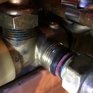

    Just to thank everyone for their advice and tips. I finished the job yesterday afternoon (before leaving the house immediately to celebrate!) and happy to report that all works fine and no drips anywhere. Annoyingly it was pressure tested to 4 bar, as once I'd turned off the water fill...

    Haha, slightly concerned about the outcome when I re-fill now! Fingers crossed. Thanks for the replies. Managed to get the bypass tube in. No matter how hard i pushed from the top down, and shook the pipe when in situ I couldn't get it in, so undid the four screws again on the plastic...

    Still really struggling to get the bypass pipe in. It's seated within the plastic manifold, with a new o-ring and some silicon grease, but just can't push it in enough to get the clip round it no matter what I try. Does anyone know of any tips? Thanks a lot.

    Thanks for that Stormer, managed to get it off in the end, by levering it away with a large flathead screwdriver. Due to length of service, there was a lot of build up around the joint, where it had partially seized... Happy to report it's back in, although now I have the challenge of...

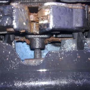

    Nice one joenineo, so good to see your solution, if I hadn't have been lucky enough to have it just open with poking around you're post would have been invaluable. Plus if it happens again in the future I know where to come! Biggest advice to anyone who's not yet had the experienced the...
