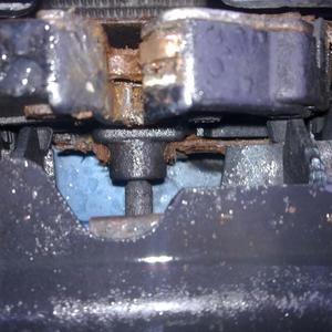

    thanks Con, went out just now to have a go, it looks like the latch is definitely in need of replacement, as i pushed the key barrel with a screwdriver so it was displaced a couple of mm out of its seated area towards the lock mechanism. the result was that the shaft went further info the...

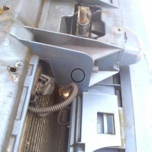

    Hi, **first of all, this topic is specific to those who have a MK1 focus (1998-2005). Most threads and forums i have read for help on this issue, all across google, deal with the MK2 focus from 2005 onwards, and as such I wanted to share my experiences trying to fix my 03 plate UK ford...

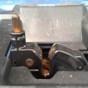

    Attempting to fix my focus 03 MK1 bonnet latch!
