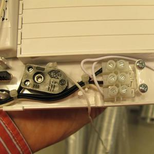

    Hi there, Here a couple of images that I took in store of the same fan: Closeup of terminals: Thanks, Stuart

    Hi there. I connected the switched live and permanent live separately. I will take a photo tomorrow so you can see what it looks like. The connections are L, LT, and N.

    Hi there, that's what I meant I did. I made the three connections to the fan (L SL and N), and when I did that I had the lights and fan on constantly no matter if I switched it off at the wall or not.

    Hello, I got a really good deal on a replacement for my knackered old extractor fan the other day, and picked one up that has all the features including run-on timer and humidistat. Only thing is it has a pullcord and I am trying to use it with an external light switch instead. I tried to get...
