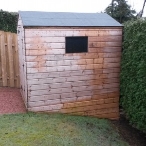

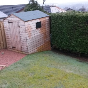

    New shed going mouldy
    Ok thanks. I take your point. Do you think gutters or extending the roof overhangs should be the priority i.e is that the main issue? The thing is, surely i would have similar mould issue at both sides, which is not the case. Also, often the rain is more horizontal than vertical.......

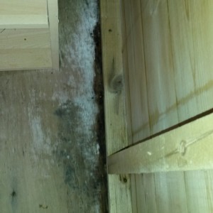

    Thanks for the feedback folks The main joist at the front is spanning between the corner posts but it may also be touching the backfilled earth. The walls sit on top of the fence boards and the back is shiplapped down to ground level. I guess i'll need to lift the ply, cut some of the fence...

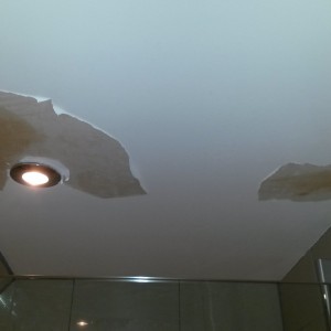

    Another peeling paint thread.....
    Thanks for the replies folks. There is a fair chance it will re-occur but i'd rather try treating it with a good quality paint first, rather than the upheaval of getting an extractor fitted near the cubicle or using wetwall on the ceiling locally
    Thanks for the reply mister. What type of 'filler' should I use here; polyfilla or something a bit more professional? Just ask at the trade counter? Is there any other methods available to improve the bond between the paint and the plaster to try and prevent the heat/moisture separating the...
    Hi Folks There is a very recent thread with similar issue......which I have read but just want your thoughts regardless, as every situation is different. I have posted photos of my peeling bathroom ceiling paint here http://www.diynot.com/diy/media/albums/ceiling-above-shower.25656/ The...
  8. Paint2
    Paint2
    ceiling abover shower cubical
    another point of note........ there is often condensation (beads of water) on the inside of the window, but i dont think its enough to be running down the wall onto the floor is the condensation a sign that some ventilation in the walls/roof of the shed is required?? thanks

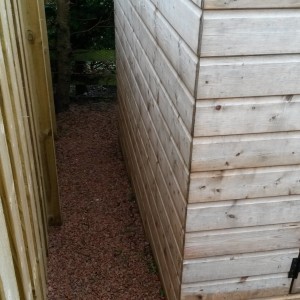

    Hi folks We had a company build us a new garden shed February 2015, but we have a fair bit of mould appearing inside. Photos are here http://www.diynot.com/diy/media/albums/shed.25655/ The shed sits on a raised timber deck foundation (see photo Shed0) due to the sloping garden. The top...

  17. Shed3
    Shed3
    INTERNAL MOULD IS NEGLIGIBLE AT THIS SIDE
  18. Shed4
    Shed4
    INTERNAL MOULD AT WINDOW SIDE, WHERE WALL MEETS FLOOR
