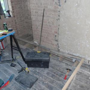

    Leveling and strengthening bouncy floor
    Hello, appreciate all comments thx. @tony, with the ply screwed both sides i can still screw the ply floor in the joist. Hope you know what I mean. Bud joining the ply sheets on the 1 inch peace might be difficult. but I guess using a 6x2 would work. @pinenot I suggested the ply. I...
    Hello unfortunately I can't disturb the plasterboard ceiling underneath. My better half would kill me :) @pinenot, ply wood sandwich and 3 full size noggins one either end and one in the middle not an option? I don't think any of the joists have dropped, I believe they have been fitted...
    @pinenot: It is a herringbone structure in the central span. Span is about 4m. Some are only 3,5m there they go around a chimney. @tony1851. I think trying to fit the ply floor to a 1 inch surface might be a struggle. especially on joints.
    X struds in the mid span. One side sits on a brick wall with a plate on top which support rafters. The other side goes through a brick wall.
    Hi all, I have a bit of trouble with my upstairs bedroom floor. It is quite bouncy. Span is about 4m. Joists are 2x7 and 42cm center. Second problem I have is that the joists are not very level. There is a 9mm drop over 9 joists but some individual joists drop up to 3mm to the next...
