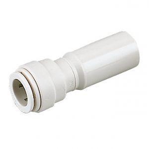

  2. Speedfit Reducer 15 X 10mm

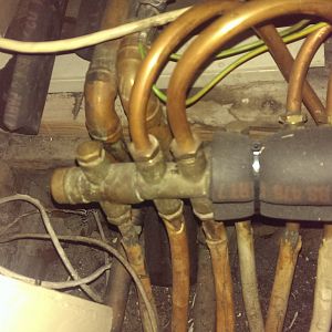

  3. 10mm Manifold
    10mm Manifold
