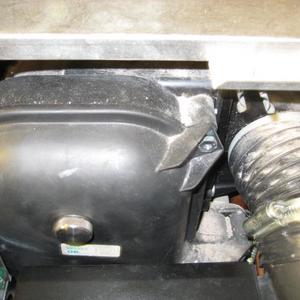

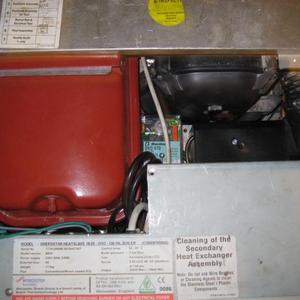

    Saturday 29th January 2011 So then, I received the Engineers reports from Worcester this morning. Perhaps you guys can make more sense of it than me? Friday 21st January. Replaced parts (7-716-100-098) job type CT01-BDWN. 1. Coil solenoid valve 1. Control box satronic 1...
  8. B
    Problem in Oil Pipe To Tank.
    John...I would have replied sooner, but for some reason I didn't get an E. Mail to tell me that there was another post. The Engineer told me that because he couldn't get that black bolted side bit off the burner unit..(I think he just wanted to replace that black bolted on bit). he would...

    P.S. John.....you may be interested to know why he replaced the burner. I went out into the Garage because I heard some banging. Ho was using a hammer to try and release a piece of equipment which was bolted to the side of the Burner. He could not release it so he ordered a new burner...
