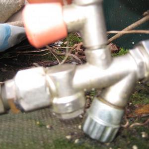

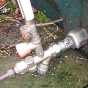

    Hello Burnerman and anyone who can help a poor cold pensioner :lol: I looked and took photo's of the connections as enclosed. I cannot see any filter though :? The temperature for the last two days has been above 4 degrees....I have been hairdrying the exposed pipes and had them covered...

    Connections From Oil Tank
