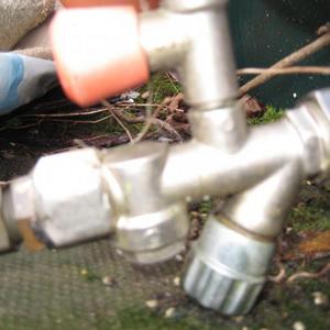

    O.K. Thanks for that. I will leave it overnight then.....and have a look at that filter situation in the morning. :)
  3. B
    Problem in Oil Pipe To Tank.
    Thank you for this quick reply. It's 9 o clock at night now...so I will have a look to see what I can see in the morning. In the meantime I will keep pressing the Lock Out button and live in hope. Cheers Boozercruiser.

    Hi Guys. I would appreciate some advice. I got my Worcester Boiler Man out because the Boiler wentinto lock out. He pulled the oil from the Tiger Loop which is just outside the Garage and now the Tiger Loop is empty. We have been down to around minus eight here in Wales, and the...
