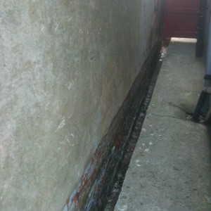

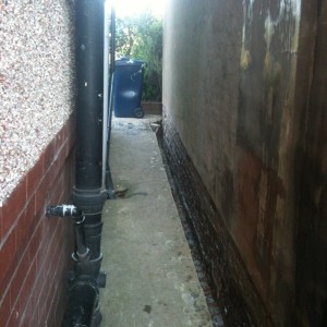

    Which solution for a damp solid brick wall?
    1) Next door own the path. 2) Yes I spoke to them first to explain the problem & get permission to have access to their property for the time required to carry out the work, at the time she seemed to understand the problems I was having & was happy for me to do the work. After it was complete...
  4. G
    I realise this is an old post now but something happened today that reminded me about it. I did actually dig out a trench along the entire side of my house, injected a DP course, put in a land drain, put one of those dimpled cellar DPMs against my wall, lined the pit with garden fabric & filled...
    Think I'll give it a go next week then & see what happens.
  8. G
    No my house has never been extended & the path has apparently been there since before next door moved in about 30 years ago. Ive checked & the path isn't above there DPC. I was hoping one of the methods I suggested or someone else could suggest will help? Cheers.
  9. G
    Just seen the other reply there. I get on very well with the lady that lives there so I'm sure she'll be ok with me doing a bit of work to the path.
  10. G
    My house was built about 90 years ago & there's about 60 years ago, so at some point in history it was built above mine but it was long before me or next door moved in. I only moved in about year ago & while ripping the house apart came across lots of different bodged attempts that must have...
  11. G
    Hi there I've got a damp solid brick gable end, unfortunately next door's land is about 150mm higher than my timber floor level. Here's a crude cross section pic: And in here's a photo of next doors path (my house on the right), not sure if you can see but it's pretty mossy & damp...
