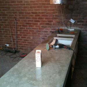

    I had a go at casting a concrete worktop and so far I'm happy with the results. Here's the mold nearly ready: [/img] And here it is so far (I will be making a cover for the back to hide the rad etc): I've gave it an initial sanding with 120 grit and am just waiting on my diamond...
