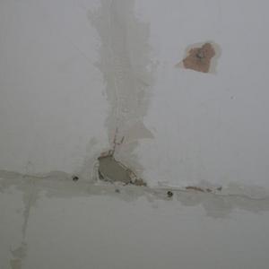

  12. S
    Repairing plasterboard ceiling hole with "bulging"
    I was a bit worried a picture would not show the bulge, but here you go. Looking along the ceiling: The board on the left is slightly lower. Looking straight up, note the fixing to the joist that has popped at the top right: There's a piece of plasterboard I have slotted in...

  16. S
    I stepped on my plasterboard ceiling on Sunday when in the loft. D'oh! There is a small half credit card sized hole and some cracks leading to it. If it were just this hole it would be easy to fix, but there's more. The hole is right on the edge where two plasterboard panels meet. Both...
