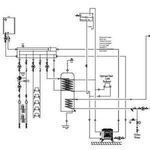

    No injector tee. There is a high limit stat on the gravity. Vent is on the primary as shown in the drawing. No vent on gravity. Picasso - Albion Centurion cylinder. coils are small bore than the 1" which is feeding them.

    The Dark Art of Open Vented Gravity Flow Systems
    Knew it was something small and silly. Yes I am a DIY'er, but a seasoned one. 20 years a chippy and I have done a lot of plumbing work. Asked several plumbers to install my system - anything apart from a sealed gas system boiler setup scared them. Anything involving 'gravity' is an art which...

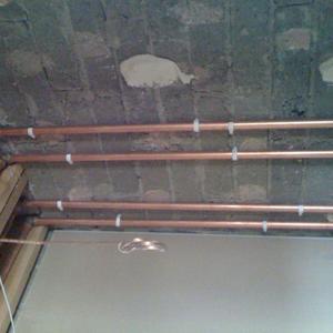

  5. pipes
    pipes
