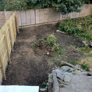

    well its been raining all day today so i am going to have a look when i get home and see if the hole is starting to fill or see if there is water running through the pipe. Im guessing is has to be taking water away (rain water) as is does not get wet down there until we have rain (and being in...

    I have attached another photo, taken from the bottom of the garden just before i dug down enough to find the pipe. As you can see its fairly far away from the house and at a much lower level. There are houses to the right / left of mine and from what i understand the rain water from 10+...

    Its only the one hole i can see so far, the rest is earth on the pipe that looks like holes. I will have a go at following this a bit further up the pipe on the weekend (if the rain stops that is)

    well i thought i would have a go myself, i did manage to find a blue plastic corrugated pipe. see photo: I was however a little supprised by this, the house is 60 years old so i was not expecting a platic pipe, i also thought it would be straight along the bottom of the garden. As you can...

    Thanks everyone, unfortunately due to the location / access and drop from the rear of the house to the garden, a digger of any size just would not be possible. On another note: if I ring the local authority / water board for advice, I would be afraid that they may insist I fix the problem, I...

    I have not seen any covers etc... i am told the previous owner tried building somthing in the garden before and may have collapsed the pipe!

    Hi, I did post a question about this a while back but I’m after some more info on it... At the bottom of my garden i am told there is a block / broken storm drain (we have only been there 3 months so a neighbour told me about the issue) whenever it rains all of the water from the neighbours...
