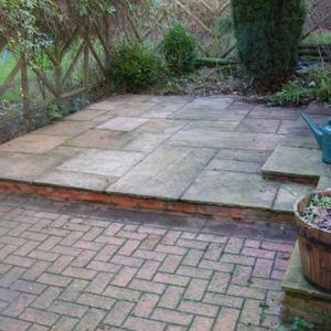

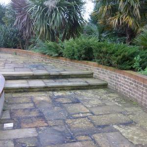

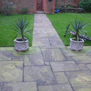

  4. G
    irregular thickness slabs
    If the slabs are a different thickness, use dabs. Use soft sand on the laying mix and sharp for the jointing. Make sure there is enough mix under the slab so that when you bang it down the dabs spread into each other. When the slab is in place make sure all the edges are filled. Force muck...

  8. patio
    patio
  9. G
    I have layed a lot of stone patios, especially yorkstone. These can vary in width from 1in to 6ins and the easiest way is definately on dabs. The dabs have to be big enough that the slab has to be bashed down into place, this helps to fill the underside of the slab. What really holds the slabs...
