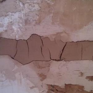

    New Plaster problem
    Update. Went with the Hardwall / skim option. All went on a treat and has dried without any cracks :-) Decided to rethink the tile size and will probably go with bevelled tiles in a brick pattern. Thank you for all your replys and help.

    New Plaster problem
    The area I have applied PVA to is where I need to plaster. Its bare brick. When I was chipping off the old tiles a chunk of plaster came away. The rest appears sound. I've tapped it and it doesn't sound hollow. So if I apply the Prime over the top of the PVA thats on the bare brick my cement...

    New Plaster problem
    Well, the good news is that due to work commitments I had to abort todays plastering session. So, cement based tile adhesive. If I go down this route what is acrylic prime and how do I use it? Will it go over the PVA I've already put on the wall? The depth of the area I'm filling is about...

    New Plaster problem
    Richardc, Would you consider Thistle Hardwall a suitable tile base?

    New Plaster problem
    Hi Everyone, Thank you for your replies. Cracked plaster chipped of. Fresh PVA applied last night mixed 5 to 1. Radiator turned off. 2nd application of PVA today at 9am 3 to 1. Hardwall plaster going on at 12 today. Fingers crossed!

    New Plaster problem
    Hi Peaps, Yes, I'm guessing it was a finishing plaster. We had a kitchen extension and it was left over after the plasterers skimmed the plaster boards. I've read on another site that I should use Thistle Hardwall as I'm plastering on to brick about 1.5cm thick. Apply PVA leave it over...

    New Plaster problem
    Hi All, I recently removed some tiles in my bathroom. An area of plaster came away with tiles. I'm going to tile over the top so I decided that I would replace the plaster. I had a bag of plaster left over from some building work 2 years ago so I decided to use that. I bought some PVA...
