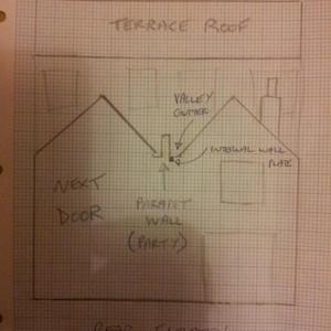

  1. Rear Elevation
    Rear Elevation
  2. Plan
    Plan

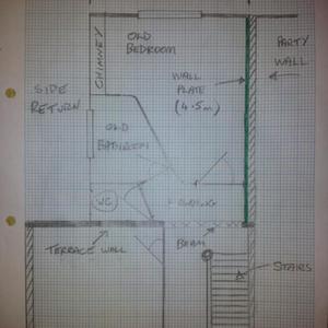

    EDITED to put pics in context, add plans and tidy up terminology. Hi All, I am refurbishing an Edwardian terrace and have uncovered a roof issue that I would like some advice on please. The roof in question is not the main roof but the smaller pitched roof over the rear original two...

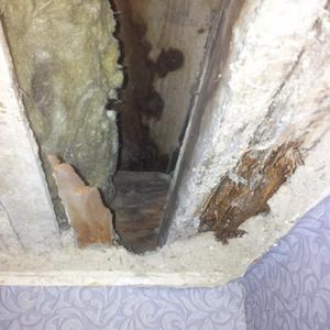

  7. Plate and joists
    Plate and joists
    View straight up from old bedroom. Flat board is the underside of the valley gutter. Rafters are tied onto a plate that runs across the joists (just under the insulation in the pic)

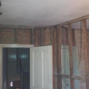

  8. Partition walls
    Partition walls
    I am concerned that the partition walls are now actually giving some support to the joists now that they have moved. I'll be leaving these in place for now.

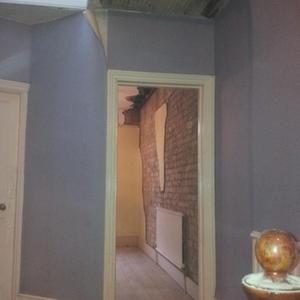

  9. View from landing
    View from landing
    Problem area (exposed) is along party wall in old bedroom and part of the landing.

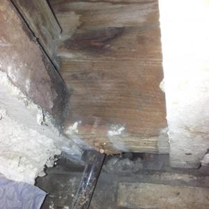

  10. Plate and joists
    Plate and joists
    Old bedroom ceiling

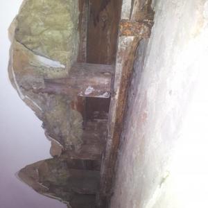

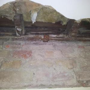

  12. Rotten plate
    Rotten plate
    Small part of ceiling above landing

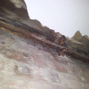

  13. Wall plate/joists
    Wall plate/joists
    This is the soundest looking part of the lot. Wall plate laps into terrace brickwork next to old conduit.
