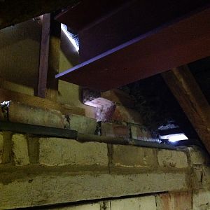

    Yes there is load bearing wall below and a steel post to the chimney side of this beam. It has all been very stressful. all I have ever asked for was a single beam (to avoid fab costs) because it can come in through the new window opening. Such a shame as this should have been quite simple but...

    Thanks. Surely the beam a is where one end will be and other on a fabricated steel post? Bricks are white engineering bricks. I'll try and upload other data pages.

    Yes, that is what I have thought. The calculations are from a paid an engineer. It was originally a 5.1m 203x133 with a support post at either end (one in stair wall) I did not want the post and wanted it to span into gable wall as was discussed originally with them. This is the new full length...

    Thanks for your replies. I am looking at the calculations given to me for a 6m ridge beam that has come out a 203x203, 46kg and it seems huge to me for a ridge beam. It is a straight forward flat rood loft dormer of aprox 5m and velux type windows in pitched side. I can't see why something so...
