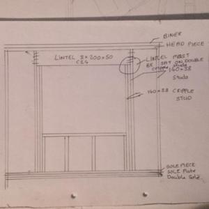

  18. W
    fitting timber lintel to top of wall.
    I've done a sketch for you showing the details of timber lintel details in timber kits hope it helps you to understand how it should look all timbers should be c24. The outside wall can have a concrete lintel or a steel lintel. Must be seated on at least 100mm either side. I build kits every day...
