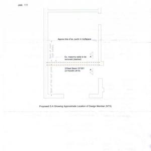

    Fitting RSJ
    As per my SE A minimum of 100mm bearing should be given to the beams at both ends. The beams can bear onto the existing (sound) masonry walls, be they block or brick. If you wish to provide padstones, all well and good.
  2. Untitled

    Fitting RSJ
    SE drawings do not identify this factor. Design member bearing length -100mm. Allowable padstone stress = 1.4MPa 3.6 N Blockwork
  6. ANGLER
    Fitting RSJ
    I need to fit 2 RSJ spanning a gap of 4.44 m. RSJ length calculated at 4.64 m. This allows 100mm to bear onto the brickwork. The problem I have is that the two supporting walls are double skin without cavities. This leaves now additional gap to allow the RSJ to fit. Next door will not be...
