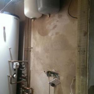

    Dan, here are the expansion vessels, you can see that he has mounted the expansion vessels for the boiler.

    I guess your concern probably related to servicing the boiler so definitely worth checking. I am currently away from home for the project so will ask mrs M to check that out. i guess its accpetable for UFH pipes not to be staright?

    And here is the evidence of Expansion vessels mounted

    I saw the Valliant cylinder unwrapped and noticed that it came with an expansion vessel. I also noticed that previous contractor also ordered Altecnic Reflex 24L Robokit Extra, another vessel. My plumber appears to suggest that previous guy did not know what he was doing as we only need one...
