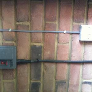

    Metal pattress in drylined wall?
    Bingo, this is on the exterior side of the wall! (Again, the daft upload has rotated pic by 90degrees! Must only like landscape orientation?) Guessing that's a SWA spur to the garage. And it explains why I couldn't pull the box out at all - there's absolutely no give in that cable! :x...

  3. Blaggins
    Thanks Les - you may be onto something there. Someone at work just suggested it could be a spur to another socket, but i couldn't think where to - but you may have just solved that. We do have a detached garage, and there is power to it - a light and a single socket, which i haven't tested...
  4. Blaggins
    Hi Gary. No, there's not another socket. It's on an exterior wall (still cavity/dry lined though). The other downstairs socket i've changed was also on an exterior wall (actually thinking about it, they all are!). Just remembered the electricity box/meter is on the other side of the wall...
  5. Blaggins
    Thanks DaftPunk! Balls. I don't get that - every other switch of socket I've looked at has a plastic box, why's this one different?! Annoying. It is the docket directly below the fuse box, so don't know if that's why? I couldn't see that the brass ring would budge, & couldn't get the angle...
  6. Blaggins
    Evening all! Hoping someone can help me. Whilst decorating upstairs a while back, I changed over our switches and sockets for more decorative ones. This included converting a couple of single sockets to doubles. All of the sockets I changed had plastic dryline boxes in the plasterboard...
