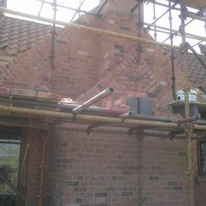

    Built this almost single handed 2nd hand brick also cut brick arches with home made keys, almost lost the will to live :)<br>

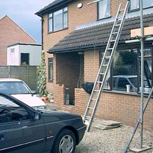

    Bog standard extension used as a studio. I took 2 paintings in payment for extras.

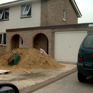

    Couple of axed arches in Swineshead village
