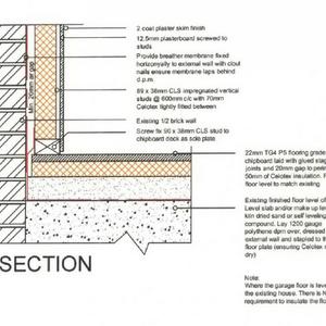

    Garage conversion - wall/floor detail, soleplate and DPM...
    Thanks pinenot! So do the whole floor with liquid DPM and 1200ga DPM? What about the breather membrane on the walls? I assume the bottom of this needs to finish on the outside of the DPM. That's why I'd left the gap so that any moisture on the outside of the breather membrane had somewhere...

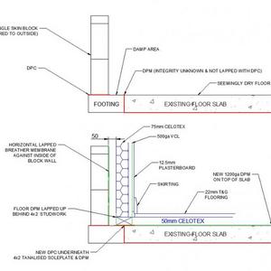

    Hi all, I've reposted this to the 'Building' forum as it wasn't get much of a response in the 'Your Projects' forum... I'm DIYing a conversion of a single block work shed in our garden to make a home office. We've had some roof leaks from the one verge due to poor mortar bedding which has...
