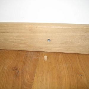

  1. SKIRTING BOARDS
    SKIRTING BOARDS
    Oak Skirting Baoards<br>Hidden Screws<br>Plug Cutting<br>Wooden Plugs creation and fitting<br>Sanding Flush

  9. B
    Skirting Board - hidden screws
    Wow - now that would have been a great idea. Although I am pretty sure if I tried then chunks of the skirting will go missing). The plugs are in. I just need to trim them to a sandable size now. As for the screws. Now you may laugh but I have used 2.5" (60mm) (SIZE 10) - Twin threaded -...

  19. B
    Oh dear... The external joins have been mitred with no profiling. The profiles matched togther where they meet each other. The internal joins have been mitred and then profiled. I was advised to do this (take the back off the join) to allow for variants in the wall angles because not all...
  20. B
    Thanks all At its worst point the skirting currently in place on the walls has a 2.5mm gap behind it which graduates to 1mm and then nothing. The plaster is sound and new and to the eye looks perfect. Still the oak skirtings simply wont hold with the 'Evo Grip' high strength adhesive I...
