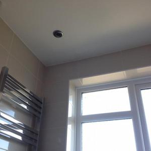

    Cheers Honda, maybe I'll go the brush route then. As you say, it gives a bit more control. I think I'll use masking tape too though or else I'm bound to get at least some on the tiles. :roll:

    Anyone? :oops: Some tips on brush vs. roller and how to keep the paint off the tiles would be really handy. :)

    Hi all, We've got a slight mould/mildew problem on our bathroom ceiling. We're about to fix the root cause of this by improving the bathroom extractor and also the loft insulation above, but just before we do those bits we want to give the ceiling a lick of paint. As you can see (or...

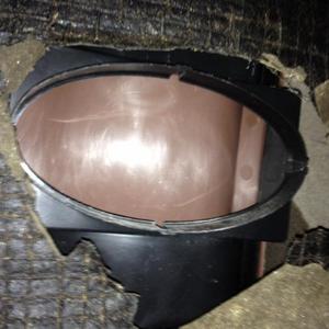

    Ahh ok yep, kinda muppetry on my part. I found the original manual (they are B&Q "Kerry" fittings apparently). Very similar to these. I hadn't realised that one is supposed to pull the whole of the chrome surround down. :oops: That said, pulling it down (and the clip thingies through the...

    Thanks Taylor, you're probably right and it's just muppet error on my part. I'll have another look tonight. :)

    So, if I go the cap route (assuming there's no better designed downlight fitting that doesn't need one), what's the best sort to go for? A large one that sits between the joists like this? They don't seem to allow access at the top though? Unless I'm missing something? :?
