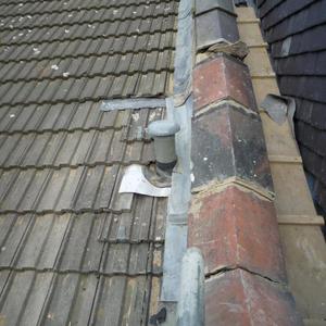

    Chimney Stack Removal and Remidal work
    To be honest, I didnt know about the Air Admittance Valve, Please could you tell me whats the difference between the one that has been put on and what you have suggested. I have paid for the survey, but the neighbour has agreed to pay for the survey and remedial work required. There is a...
  2. K
    Thanks for all the replys, I am actually going to get a roofer, not let their builders touch it. I actually had someone come round to have a look yesterday as well. They said they I shouldn't brick up the exposed bit in the loft where the chimney stack has been cut in the loft, because the...
  3. K
    Hi All, I had a neighbor remove a chimney stack with my permission, however their builders did not do a particular good job. I have had a survey conducted and this was the feedback • The concrete interlocking tiles have not been correctly cut and installed properly, they are dislodged and...
