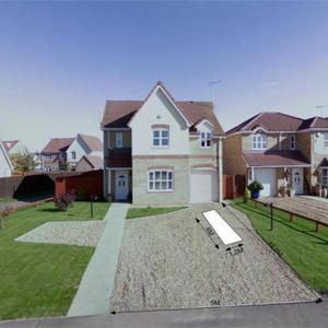

    The first pic shows the rough location of the pit, the idea is to cast the base level with the drive, this will allow me to cover with a thin guage, sectional, steel lipped plate with gravel, effectivly making the pit disappear, this will also act as a waterproofing cover. The pit will have...
