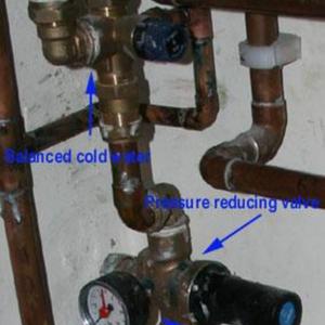

  12. PRV
    PRV
  13. photos
    photos
    photos
