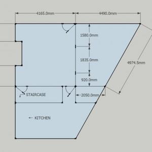

    Righto, for those interested, here's the sketchup of the Ground Floor with dimensions
  11. Untitled
  12. Ground Floor
    Ground Floor
