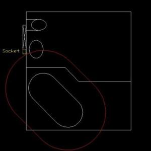

    Shaver socket - How do zones work when a bath is diagonal
    Ok, this also seems reasonable. Yes, practically the corner you specify can ONLY be reached IF you stand in the bath then lean over. There are actually taps in the way here on the side of the bath making this almost imposable, and if you do you would find if difficult to stand again. The...

  5. S
    Does this image show how the room should be zoned correctly? If so, are you saying that Dimension "A" should be greater that 600mm? I have never noticed any kind of splashing here and should find that this would be difficult - if not impossible. But I suppose this is the for ANY location...

  12. S
    Does this mean that I would have to extend imaginagy lines from the side of the bath (I think i will put up a floor plan to show what I mean) The majority of the electrics we're wire around 15 years ago. I have been reading that lighting circuits SHOULDN'T be RCD protected, but in our case...
  13. S
    Hi, We are wanting to install a shaver socket and was intending to run the cable up the wall and across to the ceiling rose as advised by our electrician (although I sometime think that qualified sparks don't always follow code). However, our bath is an open claw foot thing and is...
