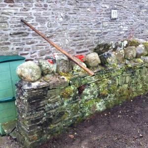

    Here are some photos of the outside area of the back of our house. Where the calor bottles and coal box are is a possible location for an outside boiler or ASHP. With a bit of clearing out and knocking out of a ledge. Is there a way I could build an under cover area for a biomas...
