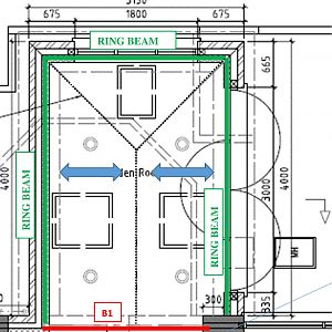

    Extension Roof. Steel hip beams and steel ridge beam or Timber ring beam?
    Thank you for help in uploading pictures. The roof pitch is circa 30 degrees with interlocking concrete roof tiles.
  2. SE-Crop-1

    Drawings
  4. M
    How do I attached a picture to this post?
  5. M
    SE-Crop-1 by Minatoar posted 27 Oct 2016 at 4:28 PMMy architect drew plans for my extension and proposed that the roof be constructed using steel hip beams and steel ridge beam, (see dotted line on drawing) and that I would need a structeral enginneer to specify the steels. I contacted an on...
