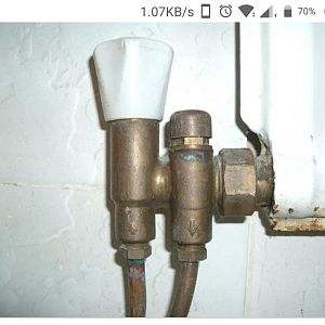

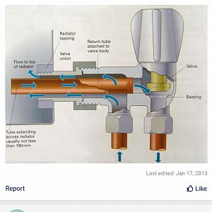

  2. A

    There are no arrows whatsoever :( Ripping it all out :)

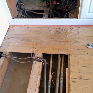

    Ok perfect many thanks at the minute im tracing all the old microbore pipes, lifting solid wood flooring doesn't help! I have another question regarding double entry radiator valves, I would like to know for certainty what is the flow and return so i can determine which 22mm pipes are the flow...

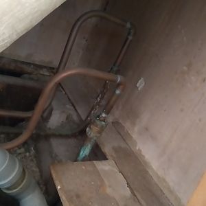

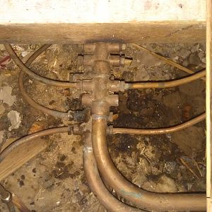

    The return and flow is 22mm copper which has two sets of manifolds supplying heat to 4 radiators Is there a 22mm to 15mm manifold out there which allows you to insert all 4 pipes in one? Or will I have to use 4 22mm to 15mm tee's instead? Per 22mm pipe, access is not great as there is solid...
