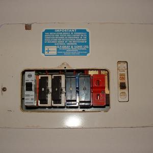

    To clarify, the fusebox has a cover which screws on top of what you see in that photo. Because the MCB is bulkier the cover has had to have a rectangle cut out of it to let the MCB fit. If that makes sense. I haven't looked inside the pull cord switch. I'm worried it could be a bit dangerous...

    Here's a pic of the CU:

    Photos to show the CU and related items supplying my shower with electricity!

    UPDATE I came home tonight having not heard from the electrician. Wife hasn't heard either. Our fuse board cover has been cut so that an MCB can be fitted. The MCB says WYLEX B40 on it. The pull cord switch hasn't been replaced. Is the MCB good enough or is an RCD required also...
