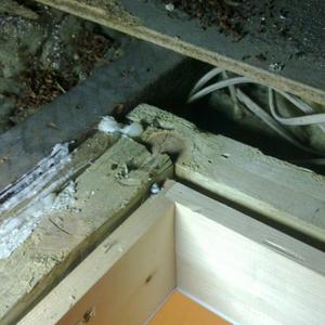

  7. MarkSmith
    Opinions on carpentry please
    We've had another carpenter take a look, and the consensus is that it's overpriced and not a brilliant job, but it's safe. The structural part is done correctly. (There were more nails in the noggin than I initially saw.) So we'll pay the man, attempt to leave poor feedback on CheckATrade...

  12. MarkSmith
    Thanks for all the replies to this. I usually do most stuff myself, but I'm busy at the moment (doing a cellar conversion of my own, plus just fitted a shower for my girlfriend, plus plenty more). The irony is the bit I was least keen on doing myself was the mitres: I can do basic...
  13. MarkSmith
    Ah, yes I see what you mean but that's the shadows in the photo. It's the right length, touching the joist, but it's fixed with its top about 1cm lower than the top of the joist. It's level with the ceiling below, apparently. It's secured with one nail to the joist, and one nail to the packer...
  14. MarkSmith
    Thanks for the replies everyone. He asked for £210 for the job (£170 labour, £40 materials) and we bought the ladder kit (B&Q). He had to enlarge the existing hole. Hasn't been paid yet. He arrived this morning and is fixing it as I write. We'll have to see what sort of condition it...
  15. MarkSmith
    Hi all, My girlfriend has just had a loft ladder fitted by a professional carpenter. Could we have your opinions on the workmanship please? Please ignore damage to the plasterwork, as this was understood and agreed "out of scope" before the job started. Thanks, Mark
