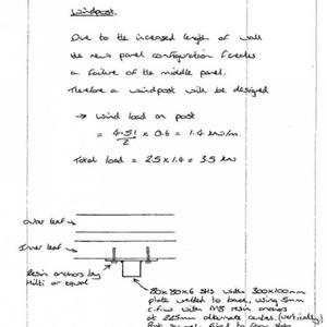

    'normal load' of end terraced req for lintel
    Sorry to drag up an old thread. Having found a SE to do some calcs for me they seem to be very different to the 2 'rough' guesses on here. He is quoting 46 kN/m and that the panel to the left of new door will be to weak for the wind and I will need a steel prop on the back of the wall and...

  12. F
    Many thanks to all helpful replies. I am finding it hard to find a SE who actually deals with private house rather than commercial, is there a register anywhere?
  13. F
    Can anyone advise please. As an educated guess, what would the load be of this house for a lintel spanning 2700mm at the bottom right starting at white door moving inwards. House is 1930, 50mm cavity, inner skin is light coloured grey brick (almost sandy) (not breeze) Room is as pictured...
