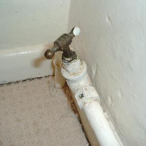

    Issues with unscrewing 3/4" imperial pipework!
    I can now add that I have been successful in removing the piece of pipe I was asking about. Now I can easily continue on with copper to the toilet. Many thanks to all you who showed some interest in my questions!
  2. T
    Many thanks for all your replies!! As well as doing some more research, I am still trying to conclude whether I have the confidence to do the job. However, thanks again!!
  3. T
    Fishhead, thanks for replying. However, I don't see how freezing helps at present. And Muggles, many thaks for your reassuring message. Refering to it, the pipe in question is 3/4". In my shed I found an old female end cap which has 3/4" stamped on it. This cap is the same size as the...
  4. T
    Hi, I am hoping for some advice from you good fellows! I have tried to add a picture, hopefully it has come out below. It will probably be helpful if I add that I do not have a blow torch! I am wanting to replace my upstairs toilet. Ideally I would like to connect to the right of the...

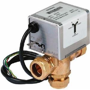

    Many, many thanks for your reassurance Jackthom. I have just done a bit of experimenting with the 3 way motor valve: 1) Firstly, the CH hadn't been on since last night; the valve lever was slack and could easily be manually moved left and right; and then returned to the left position...

    Many thanks for that Jackthom. I will go ahead a disconnect the wiring for the cylinder thermostat. Any thoughts with checking to see if a programmer or a 3 way motor valve are faulty. Also, allow me mention what the 3 way motor valve is doing at this moment: at present the boiler is...
