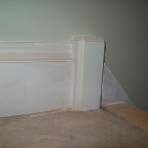

    Staircase meets skirting - making good
    I gave up! awbcm bailed me out and he kindly sent me the plinths through the post in return for a donation to a very worthy charity..... it was just breaking my heart ( and bank account ) to waste any more wood, just couldn't get those angles right with a hand plane :oops: . Thought I'd...

  7. Good Plinths
    Good Plinths

    Hello anyone whose kindly advised me on this. I've made a plinth block - just a pice of planed timber with chamfered top. I don't have a router so cannot achieve a curved chamfer like a Newel Post, so I've simply put a 45deg chamfer on top using my mitre saw. I appreciate its not a work of art...
