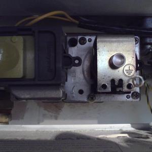

    Ideal Elan 2 - Boiler Won't Fire
    I think I may have some more information... I have had the multimeter out, and found that there is voltage across all parts in the main housing up until the solenoid. I then checked the solenoid for resistance and the multimeter registered 1, so I assume there is no continuity and the...
    Hi, this is my first post, so all help will be very greatfully received. I have an Ideal Elan 2 RS230 boiler and Honeywell ST699 control set. All installed when my house was built in the early 90's. Problem The boiler will not fire the main burner when the heating or water is supposed...
