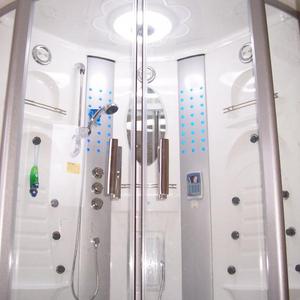

    Please help! 16 amp in line RCD with overheat protection??
    That was the bit I forgot to mention.....the manufacturer went bust! They are/were called De-Sanita. Also, yes, the power supplies the steam, lights, etc. There's no pump as it runs off my 40kw combi boiler. I had an electrical wiring diagram which showed the 1mm black cable runs from the...

  12. B
    Hi guys, We have a German made shower; the kind which is all enclosed and has lots of jets, steam, radio, etc. The problem we have is that when it was installed the electrician that installed it thought it would be a good idea to cut the cable and remove the 16 amp in line RCD and the...
